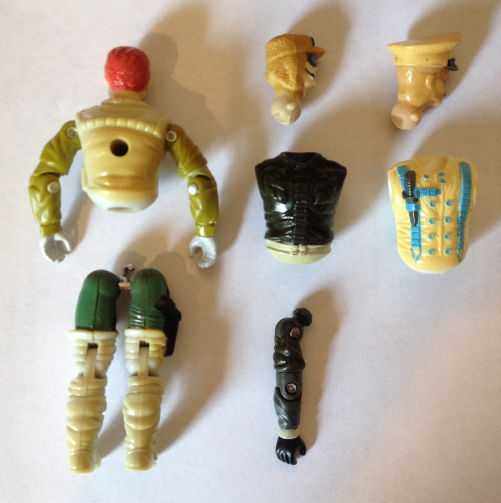

I was working on a commission and needed a Clutch head, and the only one I head was yellowed. I read about using industrial peroxide, but didn't want to fool with that. Someone said OxyClean mixed with peroxide. Then someone mentioned just OxyClean. I had some, so I mixed it hot water and left it in a window sill for a week.
It actually worked! I wanted to try it again, though, with something that I could compare. I had a severally sun burnt Rampart. I put one thigh half and lower leg. Kept it in a week, shaking it every few days. Here are the results.

1 cup of water to 1 tablespoon of OxyClean. Set out in the sun for roughly a week. I would shake up the solution daily.
Before
After
Still some yellowing, but definitely see improvement. Seems like Long Range's hair has changed color, but it looks to be the only paint affected. Next I will try OxyClean and cheap-o Peroxide.
