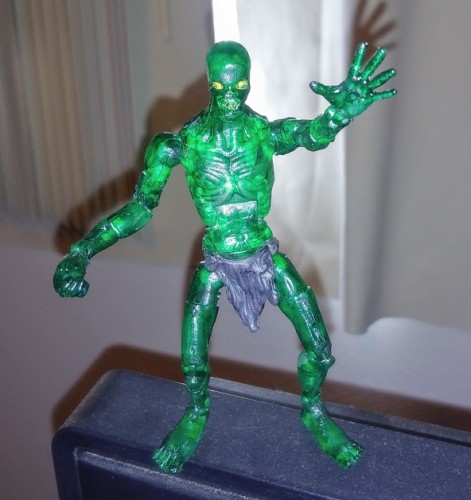

PostPosted: Mon Dec 02, 2019 8:14 pm
REALLY happy with the way it turned out. The arms do look a little long and the feet are a little big (Hobbit feet after all), but I think it works perfectly. Those brush tip sharpies are amazing.

PostPosted: Tue Dec 03, 2019 1:32 am
Looks really good!

PostPosted: Tue Dec 03, 2019 3:21 am
nice! some glow spray paint might work to give you actual gitd and seal it as well . if you do test it on something else sharpie to see if it effects it negatively.

PostPosted: Thu Dec 12, 2019 1:06 pm
Hey, that turned out nicely, well done!
