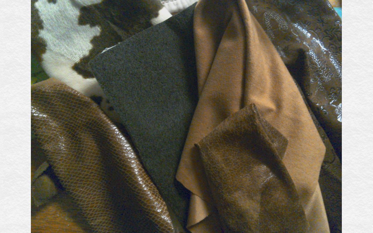

I had posted this at Boss Fighters some time ago, but should have here.
This is a sampling of 100% synthetic textiles that mimic perfectly the knap of 1:18 scaled fur, leathers, and embossed leather. The reptile skin is large and better for dragon skin, but there are a few textiles I have from non-JoAnn Fabrics sources where the scales are miniscule, and closer to our scale. Being 100% synthetic, you never have to worry about frayed edges as they can be sealed with the heat of a match. Also, these will adhere to both types of action figure plastic without much fuss at all.
