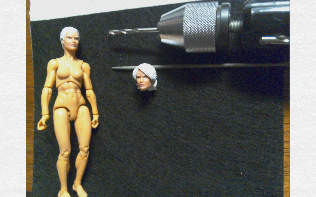

I prefer deepening the neck well too. I use a 1/16" bit and just deepen 1/16 inch down with my Fiskars hand cranked drill. Just make sure you don't hamper the neck opening as it holds the barbell in place.
