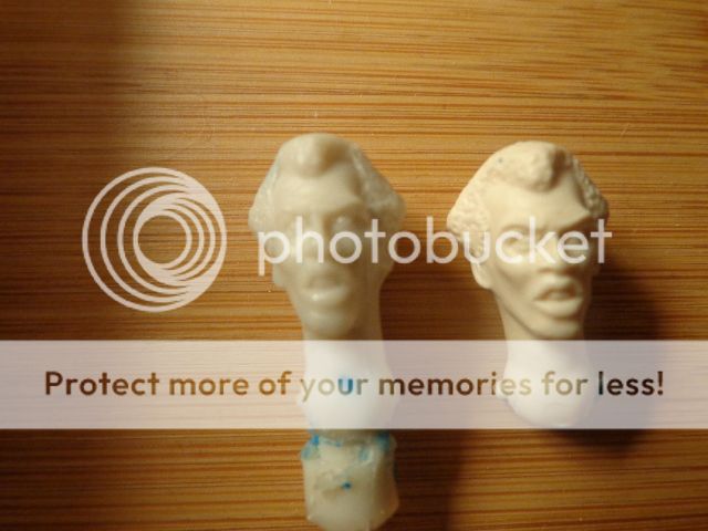

Tim 121RVC wrote:
I'm curious for your future molding results
I'll post updates as they are available. For now, let's just say I'm hoping to get some parts to ARAH fans that were promised a long time ago.

 Post subject: Re: mold-making question: Lego box
PostPosted: Fri May 13, 2016 9:46 pm
Joined: Tue Sep 04, 2007 10:34 pm
They look great.
Is that a Big Lob head?
PostPosted: Fri May 13, 2016 10:24 pm
Joined: Sun May 18, 2008 10:46 am
bigtattoo wrote:
They look great.
Yessir
