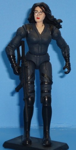

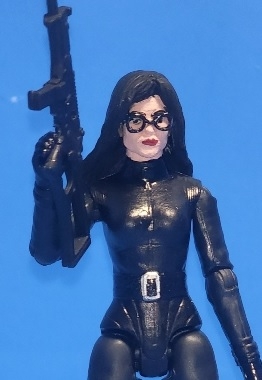

I've used ink pen springs, tiny needle nose pliers, and lots of patience.
Straighten the spring and then shape one lens frame about an inch from the end of the spring. Next duplicate that effort right beside it, do not leave room for a nose bridge, it will take shape as you form the second lens frame. Don't worry if its not perfectly flat, just use your pliers and grip both lens frames to set them on the same plane. Finally bend both earpieces back to fit the head and trim to length.
Now, to be fair, I've only used this technique twice on Baroness but it its possible.

Those look pretty dang good for one piece of wire.

Damn. That's impressive. You may have more patience than I.
