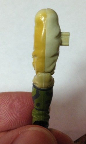

I was working on a commission and needed a Clutch head, and the only one I head was yellowed. I read about using industrial peroxide, but didn't want to fool with that. Someone said OxyClean mixed with peroxide. Then someone mentioned just OxyClean. I had some, so I mixed it hot water and left it in a window sill for a week.
It actually worked! I wanted to try it again, though, with something that I could compare. I had a severally sun burnt Rampart. I put one thigh half and lower leg. Kept it in a week, shaking it every few days. Here are the results.

Nice. Does it work for other base colours like Stinger Driver grey or Hooded Cobra Commander blue?

Holy cow! I'm impressed. I'm also interested in your precise formula. How much OxyClean did you mix into the water? For that matter, if I recall, G.I. Joe parts have a tendency to float. How did you keep it in the water? Did it have any detrimental effects on the strength of the plastic?
I've got any number of G.I. Joes, COPS, and a couple of Visionaries that could benefit from this. It's been a longstanding problem in the collecting world, and this is the first solution I've ever seen that really worked!

So far I've only tried it on flesh and tan. If I can find some other part colors, I'll try those. They did float, but didn't seem to matter since I would shake up the solution every day.
As for mixture, just guessed. I'll try it again with something quantifiable.

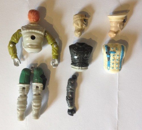

1 cup of water to 1 tablespoon of OxyClean. Set out in the sun for roughly a week. I would shake up the solution daily.

Still some yellowing, but definitely see improvement. Seems like Long Range's hair has changed color, but it looks to be the only paint affected. Next I will try OxyClean and cheap-o Peroxide.

Wow- that looks great. Good work, and thanks for the info.
